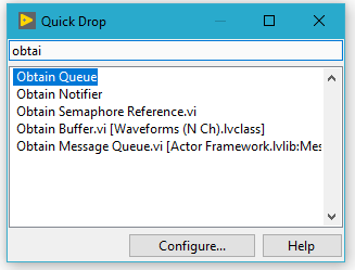

When I get to "obtai", actually just "obt" works, I get this.
 obtai

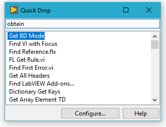

If I type the "n" to have "obtain" fully typed, I get this.
 obtain
Obtain Queue or any Obtain is nowhere in the list.  Instead it is a random bunch of functions that don't seem to have anything to do with "obtain".
Very, very strange.  Any explanations?

Obtain Queue gets me everytime.  NI is using a non-G implementation to provide a list of suggestions and it has a few alternate words that can mean the same thing.  In this case the word Obtain could also mean Get, so suggestions give you the Get as well as Obtain but the Obtain Queue is buried.  If the sorting and suggestions were done in G one could try to fix it by prioritizing the Obtain Queue over the Get suggestions.  You can modify the QD list to show the Obtain first but only if Obtain is even in the list at all.  The suggestions are limited in their results so the thing you want might not even be in the list.
https://forums.ni.com/t5/Quick-Drop-Enthusiasts/QD-Oddness-in-Search-Obtain-Queue/gpm-p/3665060
Disabling relevant search in the settings fixes this but then obviously you lose that feature.

What you say makes sense.  Now that you pointed it out, it looks like all the entries have either "Get" or "Find".  I don't see any of them say "obtain".  So I guess they are pushed so far down that they are beyond the cutoff point of the list.

I probably would still prefer if the entries starting with "obtain" remain on the top of the list, even if all these "get" entries show up. (i.e. exact matches before synonyms)

This is one of the reasons I turn off "Enable relevancy-based search" in the Quick Drop configuration options:
Another reason is that Quick Drop is slightly more responsive to fast typing when this option is unchecked.
