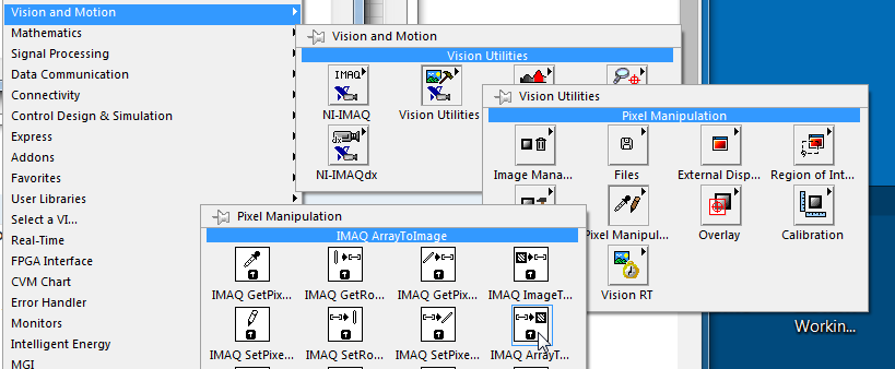

Use the 'Array to IMAQ' VI! You've already found the IMAQ Image to Pixel array function, so just use the reverse operation VI. There is 'IMAQ ArrayToImage' and 'IMAQ ArrayToColorImage' - depending on the type of image you have. You can then wire the output of that to an IMAQ Image control on your front panel.

I have the following in LabVIEW 2013:
(Unfortunately I don't have LabVIEW 8.5 to see if it is there)

Alright, I see.
the only VI  I have in "Pixel manipulation" is "IMAQ imagetoarray " ....
I must say that the computer I am using is not mine, and on top of that is really old, so I might be missing some VI, or updates ...
I ll refer to my administrator, but now I am sure that my trouble was not really from me but more from a "logistic approach".
Thank you !
