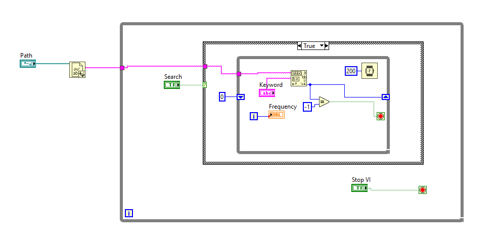

Hello, I have googled and searched the forum, but I can't find anything to get my code right. I want to search a .txt file and see how many times a keyword appears on demand. I've tried using a loop with the match pattern function, but I'm not getting the correct results. I appreciate any help given.search vi.png

You need to wire up the shift register to the "start index" input on the Match Pattern.
Personally, I would just use the Search And Replace String, setting the "replace all" to TRUE and then just use the "Number Of Replacements" output.

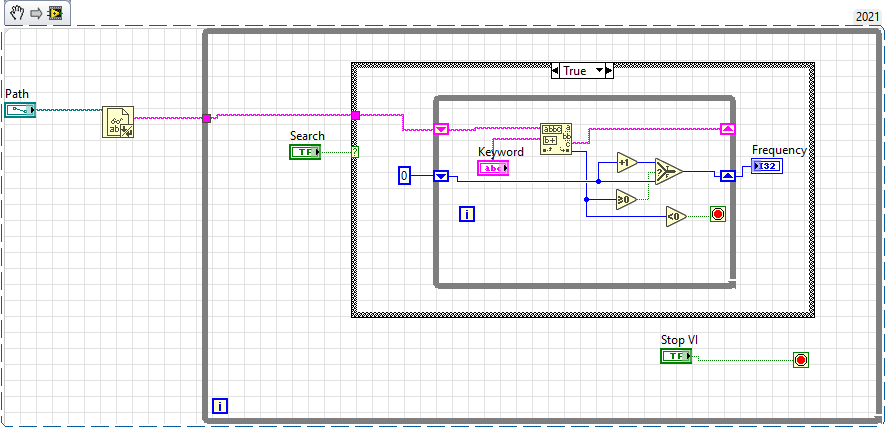

Try this:
Honestly, crossrulz solution above is much better.

Some comments to the original code:
  • No, it is not OK to spin the outer loop millions of times per second, redlining one CPU core and heating your computer.
  • NO, it is not OK to place a wait inside the inner loop. Searching should progress as fast as possible (seconds, not hours for long files!)
  • Please don't maximize the front panel and diagram to the screen! (during debugging you need to see both, as well as the help windows!)
  • The indicator you call "frequency" has the wrong representation and does not display a frequency at all.
  • Your inner loop always finds the same word forever and will never stop unless the word exists zero times.
  • Since the keyword control should be constant during the inner loop, it belongs outside it.
  • Why do you have a shift register is you don't even look at its output?
  • etc.

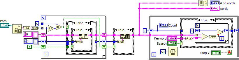

See if this can give you some ideas.
It would be even easier to place all words and their count into a map (try it!).
NOTE that you should set the keyword control to "limit to single line", else a linefeed might sneak in. You might actually want to verify that only a single word is entered (not shown)!
