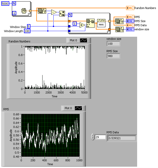

So you are now looking for something like this?  I scaled it down to test it.  You would change the 10 to 100.
Message 16 of 21
(2,958 Views)
Hi crossrulz,
Your solves my problem... I made a couple of changes to include the window length and step length in the calculations...
Many thanks,
Jack

I think what you really want is this.  You were shortening your window size and weren't stepping your windows position inside of the loop.  Also, use the Quotient & Remainder VI for integers.  It makes life a little easier.
Message 18 of 21
(2,930 Views)
Hi crossrulz,
This is brillant..!
Many thanks for your help!!
Jack
