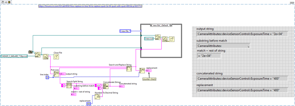

the following snippet shows rather brute-force approach, but will probably work on the .icd file, which are typically generated via NI MAX in C:\Users\<user_name>\Documents\LabVIEW Data

Here's all you probably need.
(Of course you want to add some trimmings (error handling, etc.)
Also note that I disabled EOL conversion.
Message 5 of 10
(1,781 Views)
 in a nutshell 😄
what is also worth mentioning is that "use regular expression" is turned off
