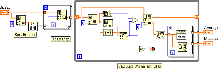

Here is my seat-of-the-pants version.  I couldn't open your VI on this machine, my example finds matches in Col 0 (your col. 1) and finds the average and max values in the other columns.  Please check for errors.
(3,746 Views)
looks good.  thanks
