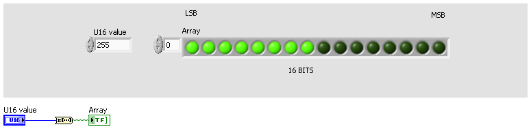

(5,266 Views)
Hi apok,
both Mark and comrade wrote "booleans are stored as 16bit values", which is wrong.
It's not about converting U16 to boolean arrays, it's only about how LabVIEW internally stores boolean values...
Message 10 of 23
