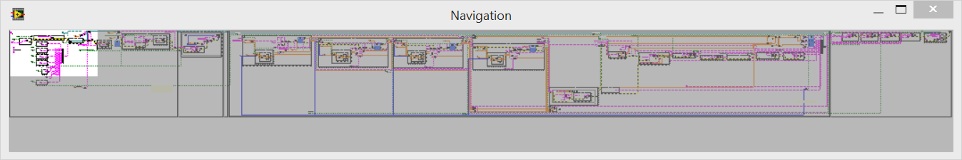

That's your VI in the Navigation window (after AutoCleanUp) on a FullHD screen (marked by the brighter rectangle in the upper left corner).
It's way to big and all I can recommend is: Use MORE subVIs!
