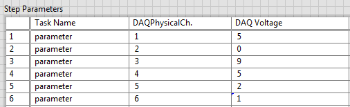

I run a test in the front panel and then the results populate in the table indicator as shown below.
At the moment to clear the table requires highlighting the table and going to Edit> "Reintialize Selected Values to Default".
This clears all the data from the table. But I was wondering if a more user friendly approach can be used e.g.
1. Upon the next Run the table automatically clears
2. Manually clear the table with a tab button
Would appreciate any feedback.
Many Thanks
