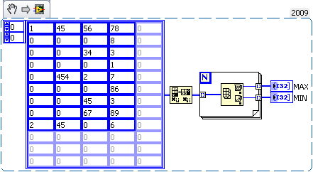

I have a 2-D array and I wish to find maxima and minima of each column of the 2-D array. Although I know how to get maxima and minima for the entire array but am not sure how to do it columnwise? Any ideas please?

Index the array inside a For Loop so that you find the maximum and minimum of the 1-D array.

Hope this helps you.

You do know about auto-indexing, right? What happens if the array is 5 columns?
Auto-indexing a for-loop that has the Array Max and Min function is the way to do it. However, you will need to transpose the 2D array before you auto-index since LabVIEW will auto-index by rows, and you want o index out the columns.

@Smercurio-What you said is right, i should have shown it using Auto indexing enabled which is really great option. I just tried to show in a very simple way.Smiley Wink
 Anyway here is the best way

Thanks for your replies. It works well now.!!
