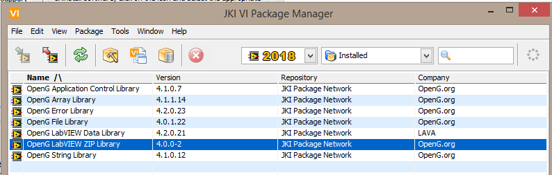

I need to be able to zip up files on my CRIO 9068 target controller. It looks like OpenG is an option, and I can install it on my computer to be able to use it in Labviews in my target VI's, but when I go to download, I get the error that the OpenG Zip library isn't installed on my CRIO. Looked at a lot of posts, but haven't figured out how to actually install the OpenG zip library on my CRIO. Any help or pointers to documentation on the subject is appreciated.

Thanks for responding. So I have installed Open G Zip on my Laptop, but I don't see it show up anywhere in NI Max when I look to install additional software. Not sure what extra steps will make it show up in NI MAX.

You need to install 4.1.0-b3 from the link in my message. Earlier packages do not support RT targets. Download that file and then in VIPM select File->Open Package File(s).
