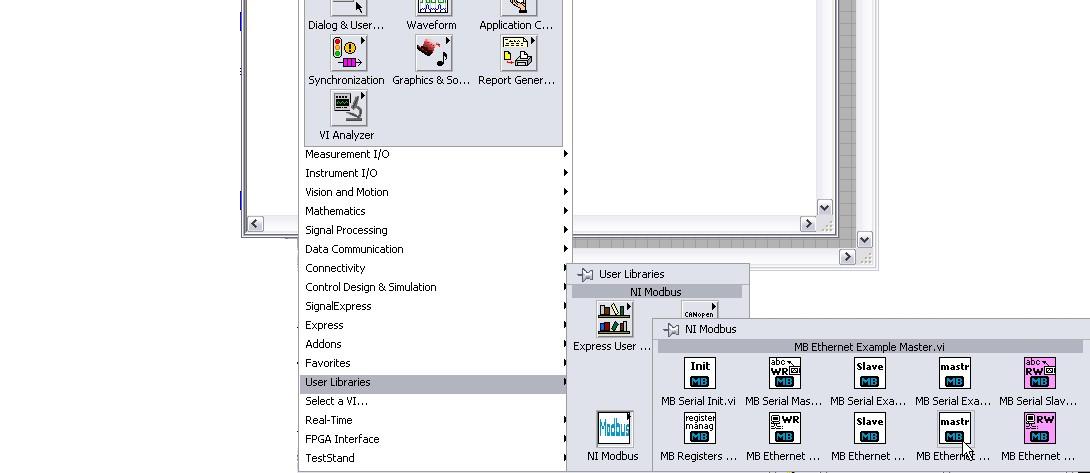

I would recommend starting with an example. I've included a screenshot of where you can find this in labVIEW.

Look at MB Serial Init.VI to set your serial port parameters.
Look at MB Serial Master Query for sending the message.
Look at MB Serial Example Master for how to wire up MB Serial Master Query.
