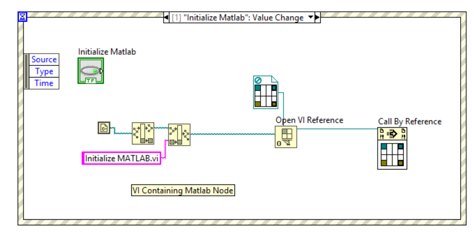

I used an event structure and call the VI containing my MATLAB node by its reference. However, the Matlab Script Launched whenever i opened the VI ( see picture).
Is there another way to launch the MATLAB Script only when I click the "Initialize Matlab" button?

Your first reference you feed into the "vi->name" property node is allready an opened reference to the vi that contains the matlab code. Thats why matlab is loading when you open this vi.
Open the VI reference by a filepath instead, then it will work (i use this exact method in my program).
Edit: See the image below - it does not matter where you place this code, a event structure is not necessary. As soon as the "Open VI Reference" node is called matlab will start.

Thanks man!
After making this change it solved my problem!
