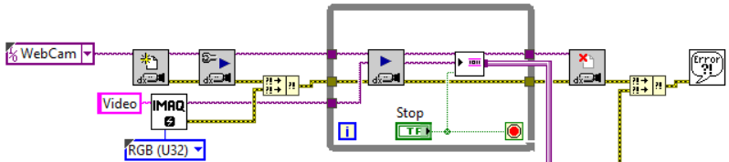

Here is the Producer.  Note that this is not a Snippet -- the Snippet comes later.Video Frame ProducerVideo Frame Producer
The initial code sets up a Grab situation, using a fixed Image Buffer (here called "Video").  Note that since our WebCam saves color images, the Image is set to be RGB (U32).  Inside the Producer Loop, we grab a frame (no timing is needed -- the Camera takes 30 frames per second) and hands it off to a Stream Channel Writer (see next paragraph).  This continues until the Stop button is pushed, a"Lt which point the Camera is Closed and the program ends.
The rectangular VI that accepts the Image Out from the IMAQ Grab2 function is a Stream Channel Writer.  Note the "pipe" output, and notice that it sits "on top of" the While Frame, indicating that the data flows right out of the Loop, essentially ignoring the Rules of Data Flow -- as the data is "produced" by the Grab function, it is "streamed" out of the Producer Loop via the Stream Channel.  The Stream Channel VI has an additional input, Last Element?, that also gets the Stop signal and sends it along to the Consumer, shown here:Video Frame ConsumerVideo Frame Consumer

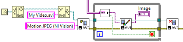

The Consumer starts by opening a file, My Video.avi, to hold an AVI Video file.  The IMAQ A  VI2 Create function has an input for the Video Codec -- the native NI Motion JPEG Codec name I got by running IMAQ AVI2 Get Codec Names.  Inside the Consumer Loop is a Stream Channel Reader, which waits for an Image to be sent to its Writer, whereupon it produces it as its output.  We write it to the AVI file and display it on an Image display.  When the Last Element? input returns True (because the Producer wrote True to it), we stop the Consumer and close the AVI.

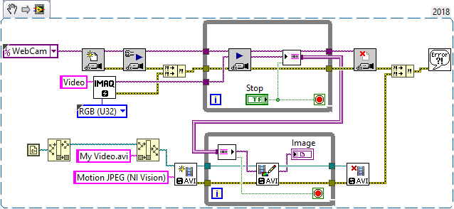

Here is the whole thing as a Snippet:DEMO Selfie AVIDEMO Selfie AVI
This routine has no problem keeping up with the Camera.  The Producer Loop runs at exactly the speed of the Camera, so if the Camera can output 30 fps, then the loop will run at 30 Hz.  Basically nothing else happens inside the loop except to pass the address of the Image Buffer to the Consumer via the Stream Channel Wire, which probably takes a few nanoseconds.  Similarly, the Consumer loop has no problem writing an AVI file at 30 fps and displaying it at that rate.
