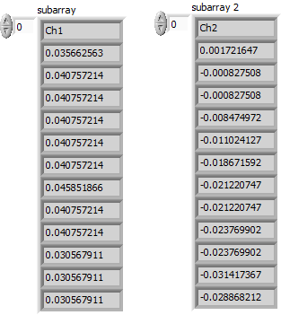

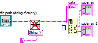

I want to make a program about the directions of eye movements. The input is from Excel Signal Data.
I input my Excel data using Read From Spreadsheet File and use the String One.
I have two signals: Ch1 and Ch2.
To make the program I have to read each column, so I have to separate the column. I tried to use index array but it didn't work, and I tried to use Spreadsheet string to array and it didn't work either because of the type of data is 2d array. What should I do to solve this?
Here I attached my vi and my excel data

Your column delimiter is a semicolon, not a double-space.
To get the first column, you need to wire the column index to the lower of the two index terminals.
Now you also need to remove the column header. See how far you get.
(Your while loop spins millions of times per second, reading the same file over and over. Seems pointless. Right?)

Thank you for the replied, It did work. How do I kwon my while loop is spins millions of times per second?
and why I have to remove the header?
Regards
Jenni
Message 3 of 19
(5,695 Views)
Your while loop is spinning as fast as the computer allows, repeating the same operations over and over. Since the results never changes, that's just pumping a lot of hot air for nothing. It is sufficient to read the file once. You don't need the loop at all.
(If you want a toplevel polling loop, you would place a short wait in it (e.g. 50ms).Look in the timing palette. Alternatively, use an event structure that only repeats the code whenever the file name is changed)
You don't have to remove the headers, but if you want to process the numbers (e.g. for a graph or calculation), the headers need to be handled separately.
