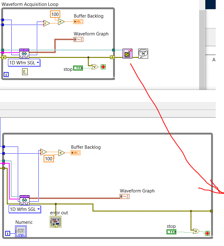

Yes, I saw error 537955. When the Cont Acq.vi stops, it leaves FPGA_SAR.vi acquiring so it can't go back and acknowledge your interupts. You can see that's the case because the Acquiring LED is blinking. Sometimes, that's acceptable because, RT applications are normally headless and don't have a stop button. I did notice a difference between your example an the shipping example that might solve the issue for you. You are missing the close at the end which should reset the FPGA back into a non-running state
You can add in a reset node for good measure too.

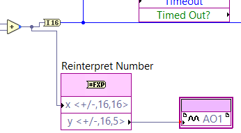

The AO0 and AO1 terminals take in a voltage. That is if you wire a 1 to them, you should get out ~1 volt. Your output into AO0 appears to be ±32,768. I'm sure your intention isn't to output kilovolts.
One way you could scale the data is to use Reinterprete Number.
One thing that's greate about LVFPGA is the simulate feature. You should be able to switch your FPGA target to simulate mode and then you'll be able to probe wires and figure out why things aren't working as you expect. The data coming out of reinterperate should be scaled by 2^-11 so if 32,765 comes in, ~16 should go out which I'm guessing is closer to your intended output range
So by adding a re-interpret number It will allow me to scale down the voltages? Is the signal output actually analog or is it digital? The scale I'm looking for is just -10V to 10V since that's the maximum input the RIO can actually read.

The signal output is a created by a digital to analog converter so a digital signal goes in and a voltage goes out. Because of the digital input and the nature of DACs, if you are able to generate voltage x, you probably can't generate voltage 0.0000001+x.
I wouldn't say "reinterpret" lets you scale down voltages, reinterpret lets you scale down digital values so that they are in the range more inline with the voltages you want to generate. In my example I scale ±32768 to ±16. If you wanted to output 1V, you would want to make sure that the number going into reinterpret was 2048 if you wanted to generate 10V you would want 20,480 going into the reinterpret function.
