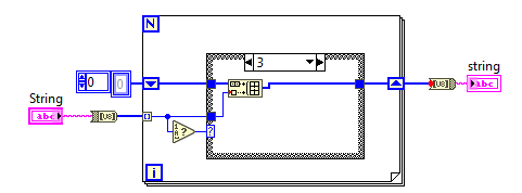

I managed to solve my own query.
VI attached for your reference. If you have any other alternatives feel free to share them Smiley Happy

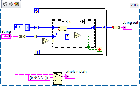

I have my doubts that your lexical processing is more efficient than the regex and the regex is certainly more compact.
In almost all cases, I would expect the performance difference to be negligible. If it is important to you, I'd be curious to see how the benchmarks show out.
I think your approach could be further simplified to use a conditional tunnel on the output. You've also created an artificial stop condition in this case where you had to know that your last digit/term character was 3.
Your approach is the top one. My regex is the bottom.
