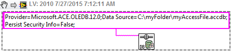

Rather than try to create an Access database, I've simply included an empty database with the installation.  Open it, build the tables as required (as your example shows) then copy it (using Copy from the Advanced File I/O palette) to wherever you need it.  Your program will need to know where it is, so storing the connection information in a configuration file (as already mentioned) is a possibility.
Here's how to use a connection string to open a database:
Jim

No! Look at the DSNs like a telephone directory. You tell the Open Database function to simply lookup the according DSN and use the stored information in that DSN to create a connection. If you have an UDL file instead it is like a business card that contains all the necessary information to create this single connection. Or you pass the Open Database function all the necessary information to create a connection, which is what that example does.
When you create a DSN entry the ODBC database configuration tool lets you select a DB provider, then invokes a special interface in that provider that shows you the configuration options. At the end these configuration options are all stored in the registry under the DSN name with a connection string. When you pass a DSN name to the Open Database connection, it looks up the DSN in the registry, retrieves the connection string and uses that to intialize the connection. Instead you can directly format your own connection string and pass it to the Open Database function. The entire DSN business is then completely left out of the whole.
The difficulty is to know what to put in the connection string. The first option that defines the DB provider(driver) is always "Provider=<some name>". After that follow the options which are provider specific as each database driver uses its own settings. Some are network connected databases and need a network address, others use a local database file and therefore need a path, and there can be several other parameters that the driver may need to work properly and also of course optional parameters like timeouts, and many others.
There are many sites that give you thousends of possible connection strings for all kind of databases, yet they often lack both the information for which version of the database driver they are (the connection strings can vary significantly depending on the version) as well as an explanation what the different settings actually mean, and copy and paste verbatim seldom works.
A better way is to create your own UDL file with the ODBC configuration tool and then open that in a text editor to get an idea what settings are needed for your specific database. Then you can use the contents of that file  as connection string and adapt some of the settings such as the actual local db file path.
