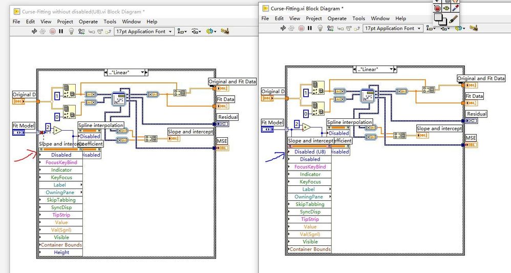

Anyone can tell me how to add a Property Node with 'Disabled(U8)'? Thanks.111.JPG

We can't read Chinese.  What does the label say?
What object is the property node associated with?  Where did you get this image from?
The pink in the header means it is a special property node.  I might be wrong, but pink might mean it is an obsolete property.

Kyle,
This did not work for me in LabVIEW2019.
I try to create a Property Node of ‘Slope and intercept’ - 'Disabled' to replace the ‘Disabled(U8)’ , there is some wrong here.

Your problem is the Fit Model control is an enum with the values of Linear, Polynomial and spline.  It is being coerced into a U8 with the deprecated Disabled (U8) property node.  So with the coercion, it seems to work.
Then you proceed to coerce that to an I32 when you add a 2 to it.  Then with a coercion to the valid Disabled property nodes which are enums of Enabled, Disabled,  And Disabled and Greyed Out,  all seems to work.
But you have to admin that coercing Linear, Polynomial, and Spline to the enabled/disabled conditions, makes absolutely no sense.
Get rid of the Fit Model Control, and just create constants from the Disabled property nodes using Right click >> Create Constant.   Change the Disabled (U8) property node with Disabled, then wire up a copy of the enum constant to that.
Really, all 3 of those property nodes belong outside the case structure, and the case should just determine which constants go to each one.  No playing with the Fit Model and the +2.
And Index Array is expandable.0
Here is your code cleaned up.
