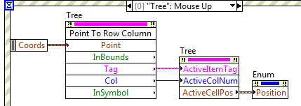

Hi Norbert_B,
In Multi Colum litst box  "Point to Row Column"  inovke node gives the  row and column number ,  but  in tree control invoke node does't gives the row and column number. Then  how i will proceed...? It give only column number.

Essentially, this is what you are looking for:
Please note that you have to account border sizes and label of the control so the code doesn't work right out of the box. Also you have to check for column width and height and if the position is valid at all before moving around the control.
