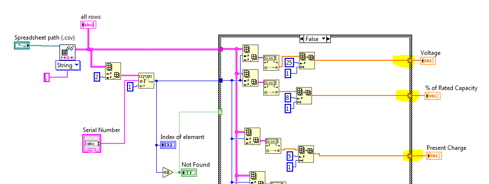

I have an array going into a case structure, I am trying to have the output of many variables, and it works but I want the output variables to be outside the case structure. Can someone help?

1. Just pull out indicators outside the case structure, wire the wire to it, and then right-click on the right-side of Case Structure, where will be junction terminal, and select "Default if Unwired". Then it'll be OK.
2. Second question regarding date is not clear... Could you explain it, please?
Sincerely, kosist90
