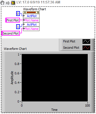

 In my program I want to select 2 different plots on the waveform chart. I want to be able to show which data is on the plots when I select it. I included a photo of what I have. I added a second plot name  in the property node to see if that would work which it did not.

Use the ActivePlot property, then use the Plot.Name property.

If you use a Waveform Datatype, the attribute "NI_ChannelName" (verify with the help file for the spelling) allow the name to change "on the fly" without having muck about with property nodes.
