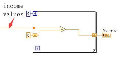

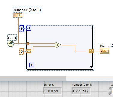

Hi, that two for loops are for selecting the elements one by one from array . what we need to make a sum is the values after calculating . and they must stay in the each case structure .  if we put them out of the case structure , how can we deal with mutiple results if we only have one output . 5.jpg6.jpg8.jpg  this is the small example i can think of . Data is out of the for loop . But in the example the "data" only get one value . and the "numeric " is the 9 times of the "data" value. then what we need is this . 9.jpgWe need put  9  values  into the for loop from the "income values"  and add them together . that is my question .       Or  how can we  change all the 9 income values into the array  and then we can use the sum array function .  Thank you for your time again .
