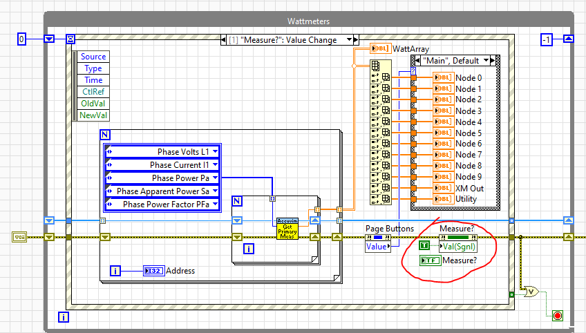

Create a Boolean indicator for your Event and use the Value(Signaling) Property Node to trigger that event when ever you want to run it.
In the picture above the Measure? Val(Sgnl) Property Node make it run the same case over and over again but it could just as easily be Val(Sgnl) for any of the other Event cases.
