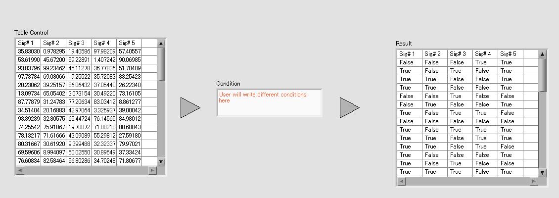

I think it could be more helpful if NI/OpenG can provide some Toolkit.
Like, it can read Signals from Table with User Conditions from FP.sample image.JPG

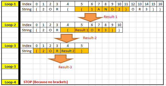

Hi GerdW,
After long time again I stated doing this task. Could you please help me in this.
As per my snippet, at 1st making array based on given String. From that string I need to check where open & closed brackets are coming to do logical operations.
For Example: (2 OR ((1 AND 2) OR 3))

Please give me any idea/sample VI for the same.
Here, 1,2 & 3 are Indices of Boolean 2D Array.

Hi Munna,
the main work is to find corresponding brackets. You could do this task this way:
- Search the first closing bracket. Then search the last open bracket before the closing one. Between both you will have your inner most term.
- After solving and replacing that term with its result you do the first point again - until there are no more brackets to find…
