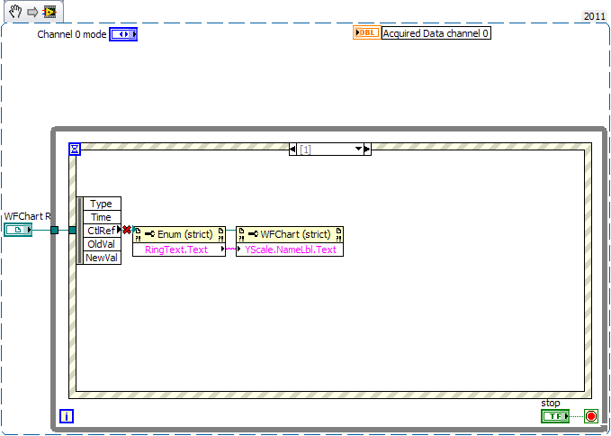

Thx for the solution, one more question, how to create the component in the middle ?
Message 6 of 8
(4,102 Views)
Hi citras,
did you read message #4? Point 2 of that message?
Message 7 of 8
(4,100 Views)
Right click on the graph and follow below
