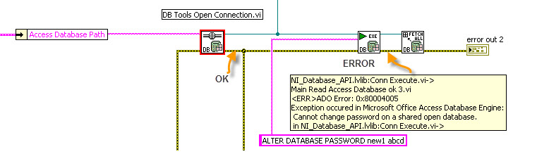

Hi Phillip:
I have tried what you sugested. Getting close but getting an error.
Looks like I'm missing a file?
I have also tried the "ALTER DATABASE PASSWORD new1 old1" following command:
Thanks for your help,
diego2000.
Message 4 of 9
(4,589 Views)
The link I provided had a comment at the bottom stating that the db should be opened exclusively with a mode=12 connection string option. Maybe that would address the error you received.

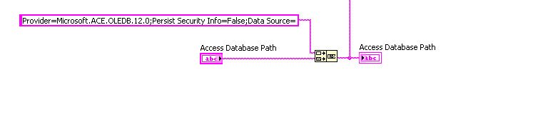

Phillip:
This is how I'm opening the Access Database. Where would I write the mode=12   ?
Where would I write the "mode=12" ?
Provider=Microsoft.ACE.OLEDB.12.0;Persist Security Info=False;Data Source=C:\New3.mdb
thank you much,
diego2000
Message 6 of 9
(4,581 Views)
Should be able to add Mode=12; to end of string...
From the link:
OleDbConnection objOleDbConnection = new OleDbConnection("Provider=Microsoft.Jet.OLEDB.4.0; Data Source=Sample.mdb; Mode=12");
Message 7 of 9
(4,579 Views)
