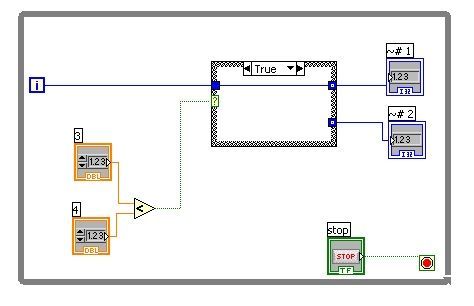

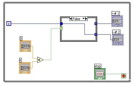

How to avoid the numeric indicator to be set to zero when case structure is false?
The numeric indicator will be set to zero when case structure is false. I chose "Use Default If Unwired" for the blue hollow dot on the edge of case structure, otherwise error will come out if I didn't do anything thing with the little blue hollow dot. How to avoid the numeric indicator to be set to zero when case structure is false?

Hi Jason,
use some shift registers to hold the values for those indicators...

Put terminal of the indicator inside the case structure, so the indicator will be updated only in one case

Problem solved. Thanks a lot.
