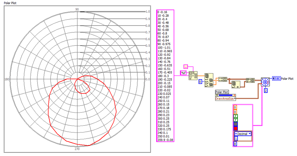

Maybe start with a polar plot?
(1,873 Views)
Hello
Thanks for your advising. What will be next step of conversion from 2D polar plots to 3D plot?
(1,839 Views)
You can use a parametric 3D surface plot. You could do an isosurface or do a sphere with a color coded surface.
