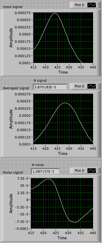

The smoothing process results in a phase shift. That causes the big peak in the "noise" signal because the peaks in the signals you subtract do not occur at the same times.  I expanded the time axes around the peaks to show the effect:
The challenge in measuring or calculating SNR is that of separating the signal from the noise.  In communications systems SNR is often defined with a sinusoidal input signal where matching the frequency, phase, and amplitude of the signal is well defined. Your signals, especially Input signal 2, do not seem to be so well defined.
You can try to align the peaks of the signal and the smoothed signal. That will help. However, I expect that the waveshape has changed somewhat as well. Note that the peak of Averaged signal is broader and more symmetrical than input signal. Thise differences will show up as part of the "noise" when you subtract.
