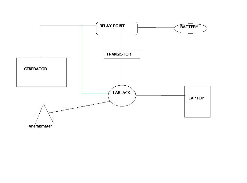

Thanks guys for your help.  Heres what we have so far..
The voltage is in DC, and the max is 15 V
I am confused about what you mean in signals.  Sadly I am doing this with little to no knowledge in circuits.  My major is totally different, but due to class requirements, I need to do this.
Heres our ideas so far.  We planned on anemometer in order to read the RPM and wind speed.  To do this we planned on making our own, and attaching a reed switch onto it, to get the amount of revolutions (RPM).
The picture below (I dont know if pictures work here or not) is a simple drawing of how our circuit would or could look like.  The generator is connected to the wind turbine.
Circuit Outline
The green is how the voltage would be measured.
If there is anyone you might need, please ask, and thankyou for all your help to everyone.
-Recon

Which LabJack do you have?  If you have a choice, the U3-HV should be a good way to go.
So are you going to have 2 reed switches?  One for wind speed and one for RPM?  It might be better to use something solid state like a hall-effect sensor or some sort of opto sensor, so you don't have to worry about the bounce of a mechanical switch.
It looks like you also show a transistor controlling a relay.  If you use a solid-state relay you can control it directly from a LabJack without the transistor.

Thanks for the reply.  We are required to use Labjack U12.
We decided to change some things up, due to complexity and time constraint.  Instead of using just the anemometer, we are going to use a tachometer to measure the RPM's and just use the anemometer's screen (displays wind speed) for the the wind speed portion.
Now here are the measurements we are required to have:
1) RPM (GRAPH, tachometer)
2) Wind Speed (NO GRAPH, just using what the anemometer gave us)
3) Amperage (GRAPH, by using a volt meter.  We dont know what ones are able to be incorportated with Labjack)
4) Voltage (GRAPH, directly between the generator and relay point)
From what we understand, this is not the BEST way to do it, but based off of money (we are college students here ;)) and it being due in 2 weeks, we felt this would be the best way.
Now is there a certain volt meter or tachometer that would work best with Labjack?

1)  This comes back to questions from my last post.  Are you going to use a reed switch?  It might be better to use something solid state like a hall-effect sensor or some sort of opto sensor, so you don't have to worry about the bounce of a mechanical switch.  Either way this will use the 1 counter input (CNT) on the LabJack U12.
2)   So, you are just going visually read this from a display and record it yourself?  Thus it does not involve the U12 or LabVIEW?
3)  We can help pick a current sensor.  What is the max current?
4)  The 15 volts max measurement is no problem.  I would work on a Google Drawing of your wiring and we can help:
