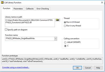

I need help uderstanding how to use ReadWrite functions from LibFT4222.dll. Lets say we have function :
FT4222 SPI Master Single Read Write
In the documentation the function is defined as:
Where function parameters are:
I have succesfully wrapped function according to documentation and i have defined it as:

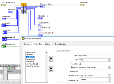

The misunderstanding is in readBuffer and writeBuffer. We can se how I defined them here:
It is, Array Data Pointer. According to documentation, calling function is for me very challenging becouse buffers are indexed when function is called. Se this:

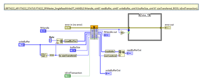

That doesn't look like you defined the VI but instead took it directly from the library that the Import Library Wizard created!
And again I have to say despite the name it is not a magicien. It can not know how to deal with those two buffers nor what size they need to be nor that the adjacent parameter is meant to tell the function how big the buffer is!
So what should you have done instead?
Create a byte array on the front panel as write input. Wire this to the writeBuffer. Connect an Array Length to this array wire and wire its output to the sizeToTransfer input.
Create an Initialize Array on the diagram, connect the array length output to the size input of the Initialize Array, a Byte constant to the type input. Wire the resulting array to the readBuffer input.
Wire the output of the sizeTransfered to the length input of an Array Subset function and the output of the readBuffer parameter to the array input of this function, to make sure the array is resized to the actually received data. Create a byte array indicator on the front panel and connect it to the output of the Array Subset function.
Do proper error handling: This function has an error return value that will tell you if something went wrong!
And that handle is almost certainly not an UINT32 but a pointer sized variable. So configure it accordingly as an Pointer Sized Integer and make the controls on the front panel an UINT64.

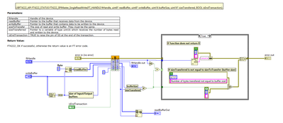

Thanks for info. According to your response is this vi ok now?
Still cannot understand similarity of delphi and C implementation that I posted before...

Thank you for the instructions and I think I got it now. Now my code in LV looks like this:
Is this better now?
(5,797 Views)
That looks about right if you only plan to ever work in LabVIEW 32-bit. Otherwise you should make the ftHandle control on the front panel to be an U64 and configure the FTHandle parameter in the Call Library Node to be a pointer sized (unsigned) integer. That way it will work for both 32-bit and 64-bit LabVIEW (provided you use the according DLL of course).
