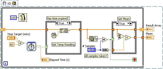

Hi Cheng,
There is a 'Mean' vi somewhere but i couldnt (be bothered to) find it.
This will take your measurements then exit displaying your mean and test results

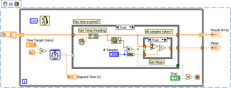

Hi Cheng,
I just realised that i never added a stop button for you to exit the vi with, here is a different version:
Rgs,
Lucither
"Everything should be made as simple as possible but no simpler"
