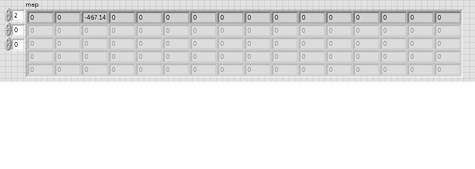

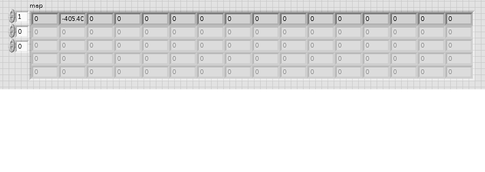

I  have a 3D data like following picture

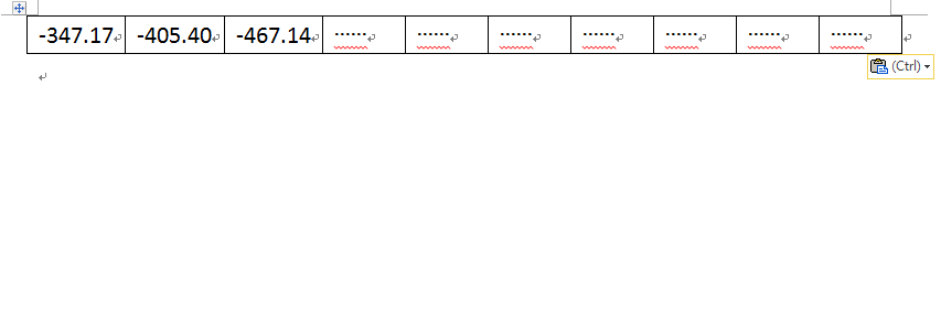

I want  change to 2D data  like following picture
How can I do?  THANKS~

In your desired result I only see a 1D array, what is the second dimension?
Also, where is this data being generated? It looks like the array might be being formatted incorrectly to begin with. Could we see the code where the array is being created?

sorrry.. The title must change 3D array to 1D array
