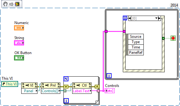

I can read all control values at once but I’m not getting how to display Help window for that particular control (By Event).
Like this I can get, But as I told in my previous post, Event cases will increase based on No. of controller/indicators (please correct me if I’m wrong).
And other issue, at Runtime we can change context help window size/position but what about Help Text indicator (which we are talking)?

Hi Munna,
- you can create user events for your controls, so the event structure reduces to just one ( or two) event cases for that help.
- you can create a case structure with a case for each control outputting the help text for that control. (Or use a lookup table approach.)
- you can create an additional window using a subVI. You can make user interfaces with autoscaling options in LabVIEW to mimic that help window.
You can do all this. You have to program it using opportunities found in LabVIEW…
