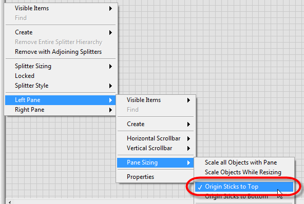

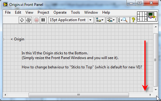

Pretty simple question here. I have VI, where the Origin sticks to Bottom (I created this by placing Splitter, change settings for both panes, then remove it):
How to change this behaviour to default "Sticks to Top" without placing splitter again?
In the other words - where is the "Pane sizing" option for the "root" Front Panel's pane:

Right click on the scroll bar and you will have a Panel Sizing menu item.

Bare in mind you need at least 1 scrollbar visable or the RCM won't activate.  And Vote here to make this even easier
