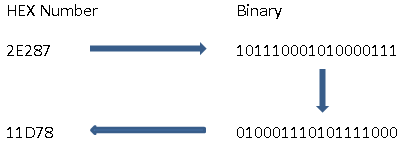

First, I want to send my 1st HEX number (2E287) to my device. Then, I want to reverse all the binary numbers (0 to 1 & 1 to 0).As the result, the new HEX (D1D78) will generate and send to my device again.
Hopes it clear.

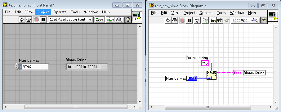

I got this far
Message 6 of 13
(4,811 Views)
Here is my problem diagram

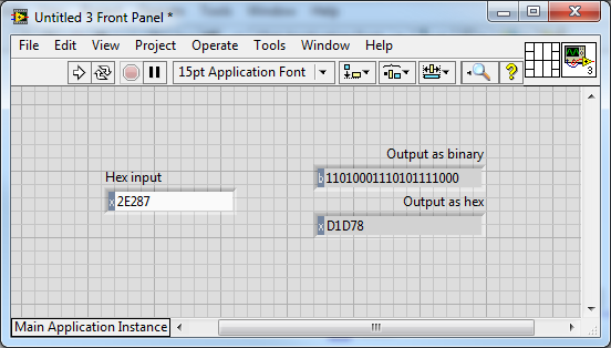

Try this:
Kelly Bersch
Certified LabVIEW Developer
Kudos are always welcome
