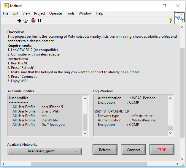

I have created a Community Example Program which uses the mentioned netsh commands. It performs the scanning of WiFi hotspots nearby, lists them in a ring, shows available network profiles and connects to a chosen hotspot (kudos welcomeSmiley Wink) :
WiFi Network Scanning and Connecting with LabVIEW - Discussion Forums - National Instruments
https://forums.ni.com/t5/Example-Program-Drafts/WiFi-Network-Scanning-and-Connecting-with-LabVIEW/ta...
