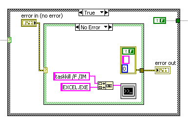

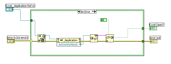

Here you go,
cheers

Addendum: Alternatively, to check to see if Excel is running you can use System Exec to issue the tasklist command and then search the output for "excel.exe".

hello,
What are the names of the two VIs which are shown in the picture after ActiveWorkbook ?
I tried to find these in variant pallette, but was not able to.
Please let me know the VI names.

They are Flatten to String and Unflatten From String. In the Numeric-> Data Maipulation.

I tried the code that you suggested on LabVIEW 2015. It returns only false in all scenarios! any alternate methods except SystemExec method?

Instead of Checking for the Active Work book, try to find the list/Count of Workbooks and Extract the required workbook name and use workbook close option via Automation refnum property.
