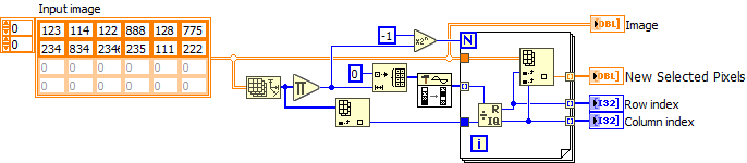

@altenbach wrote:
All you probably need to do is create an integer array containing the number of array elements (MxN), feed it through riffle array, take the first half, and use Q&R to get the random 2D indices. See how far you get. Shouldn't take code more than the size of a postage stamp.
Here's what I had in mind (check for bugs and modify as needed. This is just a very rough draft. Maybe some things need to be swapped)
(note that I tap into the "riffle index" output for simplicity)
(3,974 Views)

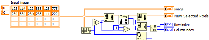

The above solution is most universal, because it works with any array, even if the elements are complicated data structures.
For numeric arrays as in this case, you can even go loop-free:
(3,963 Views)
