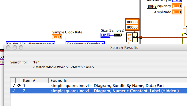

If you ALWAYS use Bundle/Unbundle by Name for your clusters, then a text search for the names will find all the places it is used.  I do not know whether this can be automated.
Lynn
Lynn
Where there's a will there's a hack way.

I just cobbled this together.  Try it and see if it works.
