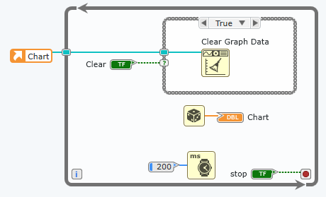

Hi, I'm using LabVIEW NXG and I'm trying to figure out how to either automatically clear arrays and charts, or have the user be able to control when they are cleared by clicking a button.  (The latter is preferable).
Is this possible in LabVIEW NXG?  I saw a solution for LabVIEW 2017 that involved creating a property node, but it seems that this is not a feature available in NXG.

For the array, you can duplicate a terminal and write to it. (assuming it is a control. If it is an indicator, just wire an empty array).
A chart maintains an internal buffer. In classic LabVIEW, you would clear the history using a property node. NXG has a tool in the panel manipulation palette, here's a simple example:

Thanks, I feel like there should be an equivalent way to clear the chart buffer also but ... (EDIT I see you have found a solution - thank you!!!)
