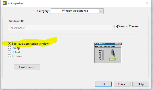

@ASH2020 wrote:
Bob, just a minor point I noticed in your reply previously. You say you try to catch aborts and close requests. Please could you explain how you catch aborts, I thought that once the abort button had been pressed there wasn't anything you could do.
Andrew
First, there should be no abort button in your executable
Now you only need to catch the Windows X in the top right corner.  You do this with an event structure and a case for the Application Close? Filter event.  Discard the event and perform a controlled shut-down that releases your resources (files ports whatnots)
Last there should be no such thing as the "User" accidentally leaving a port open.  You, as the application developer, should never let your user have accidents.
"All code is perfect! until you give it to a user!"
