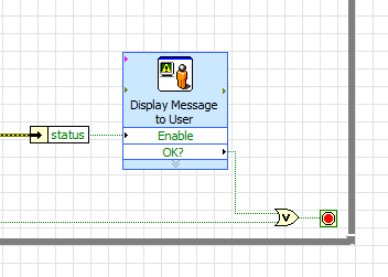

How can I end the program after I press OK in Prompt user info? I use serial line(RS232) and this part as attachment is subVI, the main program is in while loop. But I don't know how can i end the program after error=true? Is any block for that?

You can connect the error cluster right to the Stop Condition terminal of a While Loop and the loop will stop if there is an error.

I've tried this..., ok, but, I have another 2 conditions(boolean) for end of program.The first image is without loop....just indicator x=y? is led out... The second image is main program with while loop....but in this case, there is timeout error.

Just OR in the error cluster status then.

wow, it looks well, but it's without message dialog, isn't it? I want to write text "wrong choice of ports" on output after error.

But to answer your next question OR in the OK output of the Prompt User for Input Express VI instead then.

I know it was my stupid idea when i wanted keep true(boolean)  and led out to main program...because i didn't know I am able to join error cluster straight to end of while loop..
So, I insert all to main program....just in this case that error=true it shows dialog otherwise it will continue without show?

It will work better if you do it like this.
