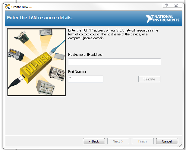

Set it up in NI-MAX (Measurment Automation eXplorer) as a new network device and select TCP/IP device then Manual Entry and put the IP and Port in the boxes.
Give it a VISA alias and you should be good to go.

Thank you RTSLVU.  I had not noticed the third option when manually adding an instrument.  I did get to the screen where I could specify the port number, however now I am at the same road block as when using the TCP open vi.  It will only validate if I use port 80 which is not one of my allowable ports.  The instrument does not respond to visa commands when port 80 is specified.   The TCP open vi times out if I use anything but port 80, but the instrument does not respond to TCP commands from subsequent TCP writes.
