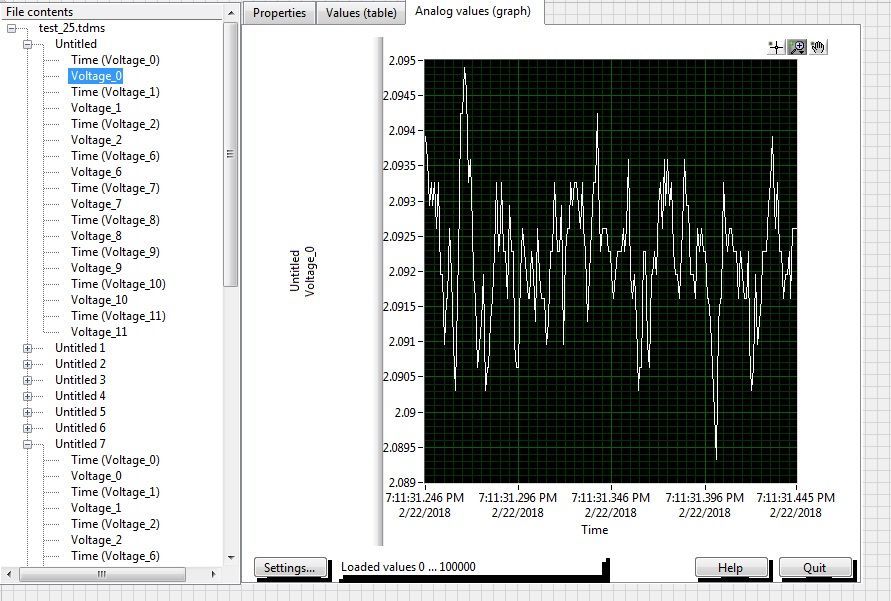

I have saved data in TDMS file format. Each TDMS file contains 30 groups and each group contains 9 channels inside. Each channel contains 200 samples. I want to join all the 30 groups in such a way that respective channels (named same in each group) should be joined. At end i need a TDMS file with 1 group containing 9 channels and each channel should have 6000(= 200x30) samples in total. A figure is showing the current hierarchy of my tDMS file. TDMS.jpg

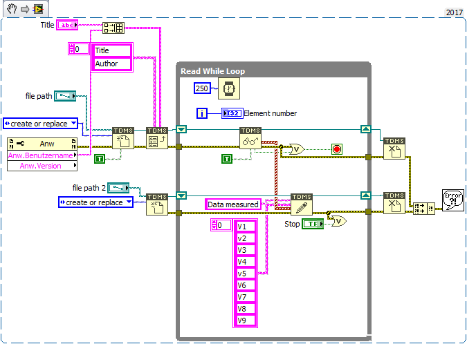

I created this code, its reading TDMS group by group but the written file contains only one group out of 30 groups. How the attached code can be corrected?

Hi irsa,
I already told you about your problem with THINK DATAFLOW!:
You read the old TDMS data in the loop, but only write to the new file ONCE AFTER the loop.
Your problem description was "read old data AND write them to a new file IN A LOOP"…
You also still use ExpressVIs, but you already learned that you got all those groups in your TDMs file because you used them.
Why don't you talk with Jawad and use plain TDMS file functions instead???

Placing write to measurement file inside the loop yields the same 30 groups not one group in written TDMS file.See the attachment.... Am I doing something wrong again in code?

Hi irsa,
Yes: you are still using the same ExpressVI…
Did you talk with Jawad? We already solved that problem of creating a TDMS file with just one group…

actually jawad gave up his task in LV and shifted to some other tool.But i have tried this thing without express VIs , it complicated the issue. Nothing from the attached code.....

Hi irsa,
That's a pity… (Which tool is he using now?)
Why should it complicate things when you can reach exactly what you are asking for?
You made the same error as I mentioned several times before:You are reading a file in a loop but only write the last data AFTER the loop has finished.
Additionally you wire (most probably) an error to the TDMSWrite function, which will not write anything in this case…
So I repeat: THINK DATAFLOW! (And do some debugging to find such problems with error handling…)

debug identified error tdms read but i am unable to solve it out. plz check the code if it is a correct way.tdms is created after running code but no groups , no data sampes found in it, simply a 1 KB TDMS file.

Hi irsa,
with your latest VI you are trying to write data to the very same TDMS file you are reading the data from.
I thought you wanted to convert one file to a different one???
This is the basic principle of "reading one file and writing the data to a different file":
