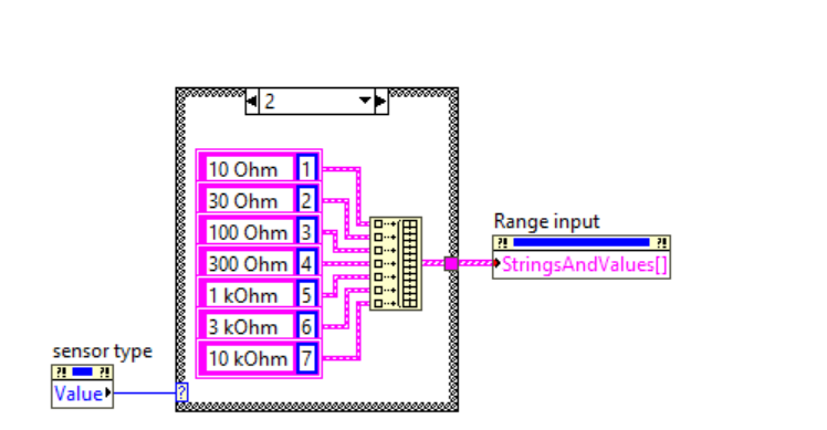

Thanks a lot for your reply. The problem is solved. I found this piece of code in the VI that I mentioned before. Now I understood how the items are linked together. Since this is a part of a large VI, I did not notice it initially. test.PNG
Glad you solved it. Of course it is not clear at all why you think you need to read from a value property node instead of the terminal. It is also not clear why you have all these loose cluster scalars (herding cats!) instead of a 1D array (of clusters) constant. You could probably even get rid of the case structure and simply index into a ragged 2D array of clusters. Easier to maintain!

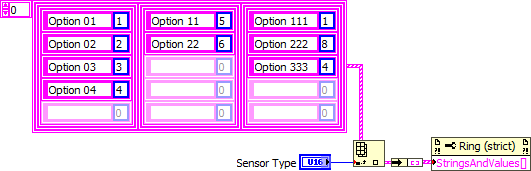

Here's how that could look like:
(A ragged 2D array can be implemented as a 1D array of clusters, each containing an array of clusters in this case. Alternatively, you could even use a map constant)
