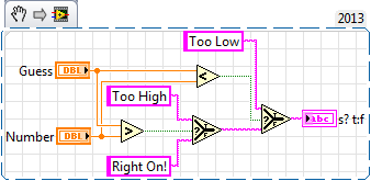

Here's one way to do it, based on the example before that was on the right track!
If it's neither too high nor too low, it must be right on!  😉

Here's what I would do. Less clutter. 😄

You basically connected values to a true/false function thing (too small) if it is true it will display too small. If false we get information from the other second true/false function thing that says if it is true that it is (too large) it will display too large. If it is false, then the only option left is the "right on."
I can't figure how to connect the while loop to this. I know the while loop has to connect from a function boolean, but since we are using 2 true/false booleans, how do I connect a while loop to this? I try connecting it to the constant indicator conected to the first true/false boolean, but it says error.

I am sorry to sound stupid if i may ask, but what is the last, string pink indicator thing called and where is it. All we have learned is string constant from the block diagram and string control and indicator from the front panel. Basically the box all the way to the right in the example altenbach is showing.
It is a string indicator and it is in the string&path palette of the front panel.
You don't even need to find it. Simply right-click on the output of "index array" and select "create indicator".
Terminals of controls and indicators can be shown as icons and that's what you probably looking for. I don't show them as icons to save diagram space. You can right-click the terminal to switch the display style.
