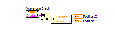

You can set up digital displays. That way you don't have to let Labview do anything for you. This is the way I like it. Here is an example of what I am talking about.
If you use the Crsr List function you get everything inside of the array of clusters. Take a look it may do more for you than what you even hoped for.

Well, that's a decent idea, but you don't get the chance to move the cursor by typing a value into the X POSITION box.
I suppose you could make that work, too, with your own code, but I didn't want to duplicate functionality that's supposed to be built in.
