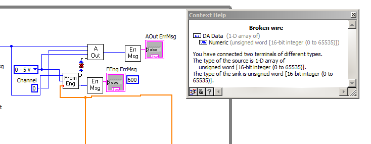

What is happening here is that I am taking 1200 samples per sec from 2 channels which means 600 per each channel in a while loop for 20m sec.
Those 1200 sample are obtained using PMD1208-LS as a 1D array (contains the 1200), so I had to split that array into two array 1D each (600 samples each).
Then I did my calculations and when I am wiring the final output 1D array (size of 600) to the "From Eng" then to "Aout" to give it to my real system using PMD1208-LS.
Its keep telling me wrong wired terminal as their type doesn't match as the type of the source is 1D array of unsigned word 16-bit int. , and the type of the sink is unsigned word 16-bit.
So the problem is how can I extract the elements from the array and feed it to the "from Eng" one by one as if it is continuous.
Any suggestions ?

Accepted by topic author rozoro
You can do it the way I suggested or Gaurav's method. Up to you.
